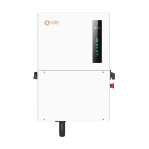

Solis S6-EH1P11.4K-H-US-RSS Hybrid Single Phase Four MPPT Inverter
The S6 (Series 6) hybrid energy storage string inverter is the latest Solis US model, certified to IEEE 1547-2018, UL 1741 SA & SB, and SunSpec Modbus standards. This high-efficiency PV string inverter provides economical, zero-carbon power and is built for all-weather conditions (Type 4X / IP 66). The S6 hybrid inverter can be DC-coupled with various batteries, offering a flexible solution for both off-grid and on-grid applications. This grid-forming inverter supports the latest high-powered PV modules, featuring 16A DC inputs at each MPPT. Protect your power supply while ensuring scalability and preserving your investment with the S6 hybrid inverter.
Highly Flexible:
  • Able to supply a wide range of continuous backup power in the event of a grid outage
  • Generates 120/240V backup power without an external auto-transformer
  • Compatible with multiple battery brands, providing up to 150 kWh of storage capacity per inverter
  • Allows up to ten (10) inverters to be stacked in parallel for maximum scalability and flexibility
Intelligent Design:
  • Supports operation in parallel with a generator and allows the generator to function as the grid source if utility power is lost
  • Optional integrated revenue-grade meter and external energy meter for production & consumption monitoring and export power control
  • SolisCloud allows for remote system troubleshooting, firmware upgrading, and configuration, reducing O&M costs
Safe and Reliable:
  • UL 1741 SA/SB and UL 9540 certified
  • California Rule 21 and HECO Rule 14H compliant
  • NEC 2020 compliant with various integrated RSD transmitter options are available for module-level rapid shutdown
  • External RSD & emergency power off switch options are also available
Efficient Performance:
  • Maximum PV input current up to 16A per string
  • Generates up to 50A/114kW of continuous backup power with up to 76A for ten seconds
  • Backup transfer (switch) time is < 10ms
  • DC to DC battery charging for optimal use of PV-generated energy
