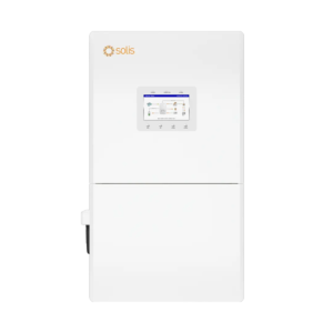

The Solis S6-EH2P16K03-SV-YD-L-US-RSS is a 16kW low-voltage hybrid inverter designed for high-performance residential energy storage systems. Featuring three independent MPPTs, this split-phase inverter maximizes solar production across multiple roof orientations or shaded arrays. It supports on-grid, off-grid, and backup modes, and works seamlessly with 48V lithium or lead-acid batteries.
Prior to purchasing this inverter, please review the battery compatibility document.
Built-in Rapid Shutdown (RSS) capability ensures full compliance with UL 1741-SA, IEEE 1547, and NEC 690.12 for residential U.S. installations. With remote monitoring via SolisCloud, installers and homeowners can easily track system performance, update firmware, and configure alerts.
The S6 Series supports up to 40A of PV input current per MPPT, integrates AFCI, and is housed in a weather-resistant IP66-rated enclosure, ideal for outdoor wall-mount applications. With advanced battery control and high-capacity PV handling, it’s an ideal solution for time-of-use optimization, self-consumption, and whole-home backup.
