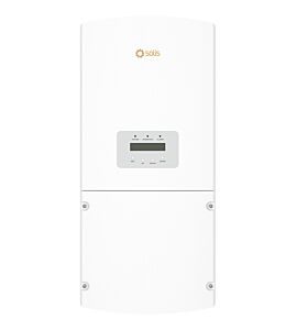

Solis 6-10KW US plus version single phase string inverters have up to 4 MPPTs which are perfect for residential rooftop systems with different roof orientations. The maximum input current per string is up to 14A, which is compatible with new high-power and bifacial PV modules. A built-in (optional) ANSI C12.20, 0.5 Accuracy Class revenue grade meter will guarantee accurate data recording.
Leading Features:
  • String current up to 14A
  • Support module level monitoring
  • Industry-leading 3 and 4 MPPT designs
  • Max. efficiency 97.7% (CEC efficiency 97.1%)
  • CA Rule 21 compliant and UL 1741 SB Certified
  • Sunspec protocol with option cellular and WiFi
  • AFCI protection, proactively reduces fire risk
  • Integrated module level rapid shutdown transmitter
  • 10 years standard warranty with extension options
  • Optional Built-in Revenue Grade Meter, ANSI C12.20-2010 compliance
Technical Specifications:
  • Max. input voltage: 600V
  • Start-up voltage: 120V
  • MPPT number: 4
  • Max. input strings number: 4
  • Rated output power: 10 kW
  • Rated grid frequency: 60 Hz
  • Max. output current for 208V grid: 43.3 A
  • Max. output current for 240V grid: 41.7 A
  • Max. efficiency: 97.8%
  • Dimensions: 13.1in x 28.8in x 9.8 in
  • Weight: 45.6 lbs (20.7 kgs)
