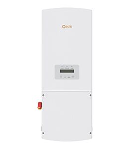

Solis-1P5K-4G-US-RSS Single Phase Inverter
Solis 3.6-5KW US plus version single phase string inverters have dual MPPTs which can be utilized in complex design environments. The maximum input current per string is up to 14A, which is compatible with new high-power and bifacial PV modules. A built-in (optional) ANSI C12.20, 0.5 Accuracy Class revenue grade meter will guarantee accurate data recording.
Leading Features:
  • String current up to 14A
  • Support module level monitoring
  • Max. efficiency 97.7% (CEC efficiency 97.1%)
  • CA Rule 21 compliant and UL 1741 SB Certified
  • Sunspec protocol with option cellular and WiFi
  • AFCI protection, proactively reduces fire risk
  • Integrated module level rapid shutdown transmitter
  • 10 years standard warranty with extension options
  • Optional Built-in Revenue Grade Meter, ANSI C12.20-2010 compliance
  • Fast and dynamic MPPTs and industry-leading DC voltage range
Technical Specifications:
  • Max. input voltage: 600V
  • Start-up voltage: 120V
  • MPPT number: 2
  • Max. input strings number: 2
  • Rated output power: 5.0 kW
  • Rated grid frequency: 60 Hz
  • Max. output current for 208V grid: 24.0 A
  • Max. output current for 240V grid: 20.8 A
  • Max. efficiency: 97.7%
  • Dimensions: 13.9in x 31.9in x 6.5 in
  • Weight: 33.1 lbs (15 kgs)
