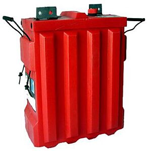

Surrette Battery - 4 Volts, 1404 Amp-hours
4-KS-25PS
$1,380.31
Note: This Battery is made to order, lead time is 8 to 10 weeks.
This battery comes with 19" 4/0 interconnect cables.
Rolls Surrette 4-KS-25PS - 4 Volts, 1404 Amp-hours
| Voltage | 4 Volts | ||||
| Series | 5000 | ||||
| Ampere Hours @ 20 Hour Rate | 1404 Ah | ||||
| Weight | 315 lb / 142.88 kg | ||||
| Length | Width | Height | |||
| in | cm | in | cm | in | cm |
| 15.75 | 40.00 | 10.625 | 27.00 | 24.75 | 62.90 |
Warranty: 5 years full replacement
| Number of Cycles | ||
| % Discharge | Series 4000 | Series 5000 |
| 20% | 2000 | 5000 |
| 30% | 1707 | 4200 |
| 40% | 1493 | 3700 |
| 50% | 1280 | 3200 |
| 60% | 1120 | 2800 |
| 70% | 960 | 2400 |
| 80% | 800 | 2100 |
| 90% | 700 | 1800 |
| 100% | 590 | 1500 |
| SKU | 4-KS-25PS |
