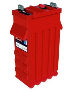

Surrette Battery - 2 Volts, 2527 Amp-hours
2-YS-31PS
$1,471.88
NOTE: Rolls Battery is behind in manufacturing. This battery currently has a lead time of 8 to 10 weeks. Please email us or give us a call if you have any questions.
Note: This battery comes with 19" 4/0 interconnect cables.
Rolls Surrette 2-YS-31PS - 2 Volts, 2527 Amp-hours
| Voltage | 2 Volts | ||||
| Series | 5000 | ||||
| Ampere Hours @ 20 Hour Rate | 2527 Ah | ||||
| Weight | 285 lb / 129.27 kg | ||||
| Length | Width | Height | |||
| in | cm | in | cm | in | cm |
| 15.50 | 39.40 | 9.00 | 22.86 | 31.625 | 80.33 |
Warranty: 5 years full replacement
| Number of Cycles | ||
| % Discharge | Series 4000 | Series 5000 |
| 20% | 2000 | 5000 |
| 30% | 1707 | 4200 |
| 40% | 1493 | 3700 |
| 50% | 1280 | 3200 |
| 60% | 1120 | 2800 |
| 70% | 960 | 2400 |
| 80% | 800 | 2100 |
| 90% | 700 | 1800 |
| 100% | 590 | 1500 |
| SKU | 2-YS-31PS |
