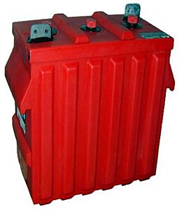

Surrette Battery - 8 Volts, 853 Amp-hours
8-CS-25PS
$1,914.47
NOTE: Rolls Battery is behind in manufacturing. The 5000 series batteries currently have an 8-10 week lead time. Please email us or give us a call if you have any questions.
Note: This battery comes with 19" 4/0 interconnect cables.
Rolls Surrette 8-CS-25PS - 8 Volts, 853 Amp-hours
| Voltage | 8 Volts | ||||
| Series | 5000 | ||||
| Ampere Hours @ 20 Hour Rate | 853 Ah | ||||
| Weight | 424 lb / 192.32 kg | ||||
| Length | Width | Height | |||
| in | cm | in | cm | in | cm |
| 28.25 | 71.76 | 11.25 | 28.58 | 18.25 | 46.36 |
Warranty: 5 years full replacement
