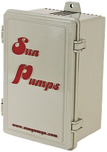

SunPumps Solar Pump Controller PCC-240-BLS-M2S
NOTE: For submersible pumps only
Sun Pumps PCC-BLS series pump controllers are high quality, micro-processor controlled DC power converters designed as the interface between a sensorless brushless DC submersible pump motor and the solar array. The main purpose of a PCC-BLS series controller is for motor commutation, supply maximum power point tracking for the solar modules and provide protection for the controller.
The PC series controllers will boost the current of solar modules in low sunlight conditions while holding the voltage of the solar modules at the maximum power point. This allows a pump to start much earlier in the morning and stay running longer in the evening.
Sun Pumps PCC-BLS series pump controllers have many unique features designed specifically for water pumping. All PCC series controllers include a pump speed control circuit, a remote switch circuit, a sensor-less low water cut-off circuit, an electronic circuit breaker and indicator lights. The PCC series controllers also include an LCD screen that displays motor voltage, current, motor speed and power.
The controller is mounted in a high quality, powder coated, cast aluminum enclosure rated for outdoor use.
  • Nominal Voltage Range: 180-240 Volts DC
  • Max Open Circuit Voltage: 380 Volts DC
  • Minimum Open Circuit Voltage: 220 Volts DC
  • Max Load Current: 12.5 Amps DC
