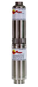

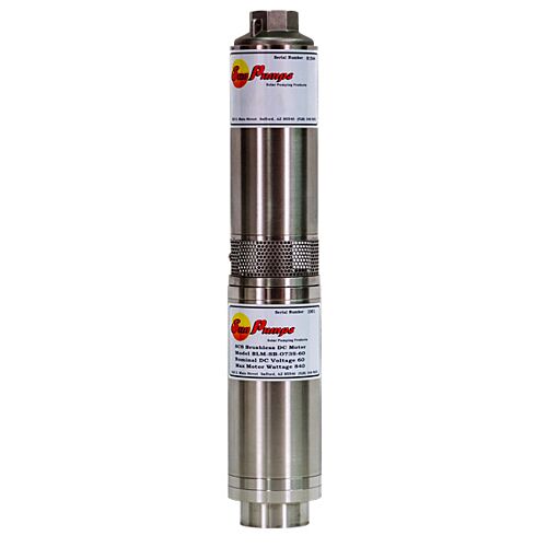

Model: SCS 12-127-60 BL
Product Specifications:
  • Flow Range: 10-16 GPM (38-60 LPM)
  • Depth Range: 50-140 Ft. (15-43 Mt.)
  • DC Voltage Range: 30-60
  • Controller: PCA 60-BLS-M2S
  • Minimum Well Diameter: 4" (100mm)
  • Discharge Size: 1 1/4" NPT
