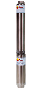

SunPumps Submersible Solar Pump SCS 17-280-180 BL for 17GPM, 280FT Head, 180 Volts DC
SunPumps manufactures some of the highest quality water pumps and accessories available for the solar marketplace. When you need a reliable pump for your home, farm, ranch, or remote location, you can always depend on the quality and craftsmanship of the SunPumps brand. They are constructed of high quality corrosion resistant stainless steel parts, manufactured in the U.S.A., and backed with a no nonsense two-year warranty.
The SCS centrifugal DC pumps are available in models that operate on 150 to 3,000 Watts of power and a voltage range from 24 to 240 Volts. The submersible motor incorporates brushless DC technology with a permanent magnet design. The motors do not contain electronic components, which means they are less susceptible to damage or malfunctions. Due to the component materials, the pumps are resistant to wear, minerals, and algae deposits. What does that mean for you? It means that once the pump is installed, it is very low maintenance and seldom needs any attention.
SunPumps SCS submersible pumps may be installed in wells, lakes, rivers, and cisterns or tanks. The pumps are pollution free, corrosion-free, self lubricating, and very quiet. When you need to pressurize a water system or fill water tanks when grid power is not available, there is no system more dependable than one that relies upon a SunPumps brand pump.
Model: SCS 17-280-180 BL
Product Specifications:
  • Flow Range: 10-25 GPM (38-95 LPM)
  • Depth Range: 170-320 Ft. (52-98 Mt.)
  • DC Voltage Range: 120-180
  • Controller: PCC 180-BLS-M2S
  • Minimum Well Diameter: 4" (100mm)
  • Discharge Size: 1 1/4" NPT
