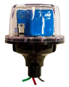

The MidNite Solar surge protection device (SPD) is offered in three different models: MNSPD115, MNSPD300 and MNSPD600. The model you need will be determined by the voltage of the circuit being protected. The SPD is designed or AC and DC circuits for indoor and outdoor applications. These can be used on single devices or can be connected to an electrical load center. Blue LED indicators will light when voltage is present, showing you that your system is protected.
Nominal Voltage 0 to 115 Volts DC
0 to 90 Volts AC
Max Continuous Operationg Voltage 180 Volts
Clamp Voltage @ 100A 295 Volts
Peak Current (8/20 μs) 115kA (Full Device)
57.5 kA (Each Section)
Energy Absorption 1,120 J (Full Device)
560 J (Each Section)
Suggested Placement 12V, 24V or 48V DC Battery Bank
Operating Temp. Range -40°C to 85°C
Response Time <1 μs
