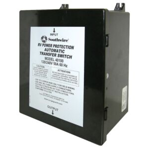

Automatic Transfer Switch 50A Hardwire
Transfers to generator power automatically when energized after 30 second delay. When both shore power and generator power are available, generator dominates after a 30 second delay. Once the generator is shut down, shore power activates after a 3-4 second delay.
Features & Specifications:
  • Southwire Model Number: 40100
  • Mechanical interlocking contactors
  • Time delay at power up
  • Dual contactor arrangement
  • Does NOT provide surge protection
  • UL/CUL listed
  • 12.72”W x 16.13”L x 7.78”D
  • Contactor Rating - 50A, FLA
  • Time Delay at Power Up (Shore 3-4 Sec, Gen 30 Sec.) - Yes
  • Generator Dominant - Yes
  • Frequency: 60Hz
