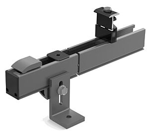

Tamarack Solar Flush Mount 8 Module Kit
Tamarack Solar New flush mount is a visually appealing, low profile, photovoltaic (PV) module installation system that significantly lowers PV module installation cost.
These new rail kits contain all the parts required to mount 8 typical 60-cell or 72-cell modules that have a thickness of 30mm to 40mm. Can be used with any roof attachment that can accommodate a 5/16-inch bolt.
Certified to meet local and International Building Codes when installed in accordance with this manual. The design load rating meets the minimum requirements of 10 PSF downward pressure, 5 PSF upward pressure and 5 PSF down-slope load. Module orientation may be portrait or landscape. Designed for use with most third-party roof attachments including Solar Roof Hooks, Quick Mount PV, Ironridge Flashfoot, S-5 Clamps, etc.
8 Module Kit 1.6 Rail Black Finish includes:
  • 84" Rails - box of 8 rails for 8 modules
  • 8 Splices
  • 16 Rails mounts
  • 20 50/50 clamps
  • 8 Channel end clamps
  • 8 End caps
  • 24 Wire clips
  • 4 Ground clamps
  • 8 MLPE Adapter
