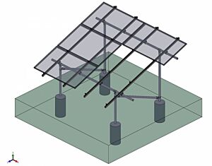

Tamarack Solar Ground Mount 3 Module First Column Kit for use with 3.1inch Rail
The Tamarack Ground Mount System is assembled using 3.1 rails and 2-inch schedule 40 or 80 galvanized steel pipe, which must be purchased separately. Each column requires four 66-inch rails and two structural splices, combining to form two 132-inch rails. This configuration supports mounting three modules per column, with a maximum PV module width of 43 inches." Parts included in kit no longer has two 85" and 42.5" rails, and has been replaced with four 66..
The system comes with all parts needed except for the pipe and concrete. Assembly is quick and easy and can be used on almost any terrain.
  • Simple Design - Arrays can be in columns of 3 or 4 module high and any width required
  • Easy to install - No welding or drilling and two wrench sizes fit all fasteners
  • UL 2703 Listed - All components meet the UL 2703 standards for bonding and grounding
  • PE Certified - Pre-stamped engineering letters available for most states
  • Easy to configure - Unlimited system size with tilt angles from 0 to 45 degrees
  • Visually Appealing - Simple to adjust for perfect alignment, even if the surface is irregular
  • Simple Wire Management - PV cables and wiring for module-level electronics fits inside rails to avoid time-consuming wire management
  • Extremely Robust - For use in locations with wind speeds up to 170 MPH and ground snow loads of up to 50 PSF
Parts included in the kit:
  • Four 66" rails
  • Four 2" T-Fittings
  • Two splices
  • Four pipe mount clamps
  • Eight 5050 clamps
  • Four end caps
  • Eight wire clips
  • One ground clamp
