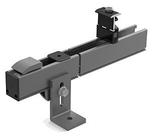

The Tamarack Flush Mount System 2 Module add-on column kit. box of 2 rails for 2 modules, includes 2 splices, 4 rail mounts with L-Feet, 4 50/50 clamps,6 wire clips and 2 MLPE Adapters for mounting micro inverters and optimizer on the Tamarack Solar rails, under the solar panels.
Kit contains parts required to mount 2 additional modules with widths of up to 41.5-inches in portrait orientation.
Expand Tamarack 4 or 8 Rail Kit with an additional 84-inches of rail to accommodate modules wider than 41.5-inches.
  • Best Wire Management - PV cables and wiring for module-level electronics fits inside rails to avoid time consuming wire management.
  • Use Any Roof Attachments - Included L-feet mount to Tamarack composition shingle flashings, S-5! metal roof clamps or any roof attachment that can be used with a 5/16 inch bolt.
  • One Wrench Size - Install with ease and minimal tools. A 1/2-inch socket fits all fasteners.
  • UL 2703 Listed - All components meet UL standards and have Class A Fire Rating for Type 1 and 2 modules.
  • PE Certified - Pre-stamped engineering letters available for most states.
