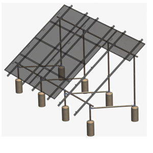

Introducing a groundbreaking advancement in railed system technology – the first significant innovation in years.
Installation is simplified with a single tool, making the process straightforward and highly intuitive.
To accommodate different snow and wind conditions, two rail profiles (heights) are offered.
Available in two manageable lengths, 93 or 66 inches, these rails are designed for ease of shipping, transportation, stocking, and handling. The 7-foot rails can even be shipped via UPS, offering unparalleled convenience.
Our rails incorporate a unique internal splice design, enabling the economical use of shorter rails. This low-cost splice is tool-free to install and seamlessly integrates without obstructing module clamps or roof mounts.
Featuring an industry-first innovation, our 5050 Module Clamp functions both as a mid-clamp and an end-clamp across all module types. Despite imitations, our original design remains unparalleled in its effectiveness.
For those seeking a polished, premium look, our Channel Clamp can be utilized at row ends to allow rails to be cut flush with module frames, enhancing the system's aesthetics.
Experience superior wire management through the use of open rail channels for both module and MLPE wiring, setting a new standard for efficiency and organization in railed systems.
The system comes with all parts needed except for the pipe and concrete. Assembly is quick and easy and can be used on almost any terrain.
  • Simple Design - Arrays can be in columns of 3 or 4 module high and any width required
  • Easy to install - No welding or drilling and two wrench sizes fit all fasteners
  • UL 2703 Listed - All components meet the UL 2703 standards for bonding and grounding
  • PE Certified - Pre-stamped engineering letters available for most states
  • Easy to configure - Unlimited system size with tilt angles from 0 to 45 degrees
  • Visually Appealing - Simple to adjust for perfect alignment, even if the surface is irregular
  • Simple Wire Management - PV cables and wiring for module-level electronics fits inside rails to avoid time-consuming wire management
  • Extremely Robust - For use in locations with wind speeds up to 170 MPH and ground snow loads of up to 50 PSF
Parts included in the kit:
  • Four 93" rails
  • Four 2" Tee-Fittings
  • Two splices
  • Four Pipe Mounts
  • Ten 5050 Clamps
  • Four End Caps
  • Eight Module Lead Clips
  • One Ground Clamp
