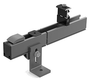

Tamarack Solar 90828 Flush Mount 2 Module Add-On Column Kit for use with 2.3 inch Rail
Note: This rail kit doesn't qualify for free shipping, it is classified as an oversized item.
Kit contains parts required to mount 2 additional modules with widths of up to 46-inches in portrait orientation.
Expand Tamarack 90750 - 4 Rail kit or 90743 8 Rail kit Rail Kit with an additional 93-inches of rail to accommodate modules wider than 46-inches.
  • Best Wire Management - PV cables and wiring for module-level electronics fits inside rails to avoid time consuming wire management.
  • Use Any Roof Attachments - Included L-feet mount to Tamarack composition shingle flashings, S-5! metal roof clamps or any roof attachment that can be used with a 5/16 inch bolt.
  • One Wrench Size - Install with ease and minimal tools. A 1/2-inch socket fits all fasteners.
  • UL 2703 Listed - All components meet UL standards and have Class A Fire Rating for Type 1 and 2 modules.
  • PE Certified - Pre-stamped engineering letters available for most states.
Included:
  • 2 rails included
  • 2 Splices
  • 4 50/50 clamps
  • 4 Rails mounts and L-feet
  • 6 Wire Management clips
  • 2 MLPE Adapter
