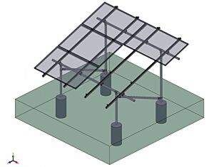

Tamarack Solar 91467-A Ground Mount 3 Module Add-On Column Kit for 2 Posts
Easily build a durable solar array using our 3.1 rails and UL 2703-certified module mounting components. This ground mount system is designed for use with locally sourced 2-inch schedule 40 steel pipe and concrete, allowing flexible column spacing based on your site layout. Each Ground Mount Kit includes all necessary hardware—except pipe and concrete—for a simplified, cost-effective installation. Smaller systems can ship economically via UPS.
Note: 2-inch schedule 40 steel pipe and concrete must be sourced locally and are not included
  • Simple Design - Arrays can be in columns of 3 or 4 module high and any width required
  • Easy to install - No welding or drilling and two wrench sizes fit all fasteners
  • UL 2703 Listed - All components meet the UL 2703 standards for bonding and grounding
  • PE Certified - Pre-stamped engineering letters available for most states
  • Easy to configure - Unlimited system size with tilt angles from 0 to 45 degrees
  • Visually Appealing - Simple to adjust for perfect alignment, even if the surface is irregular
  • Simple Wire Management - Cables and wires fit inside rails
  • Extremely Robust - Rated for wind speeds up to 170 MPH and ground snow loads of up to 70 PSF
