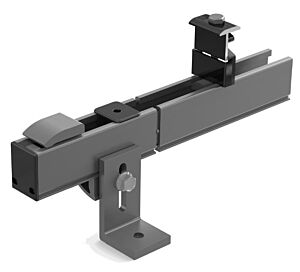

Kit contains all parts required to mount 8 modules with widths of up to 46-inches in portrait orientation.
1.6-inch rail height for Max span is 8', max wind is 190 MPH, and max snow load is 120 PSF.
Module clamps included in kits fit frame thickness of 30mm to 40mm; additional clamps available for modules with thicker frames.
  • Best Wire Management - PV cables and wiring for module-level electronics fits inside rails to avoid time consuming wire management.
  • Use Any Roof Attachments - Included L-feet mount to Tamarack composition shingle flashings, S-5! metal roof clamps or any roof attachment that can be used with a 5/16 inch bolt.
  • One Wrench Size - Install with ease and minimal tools. A 1/2-inch socket fits all fasteners.
  • UL 2703 Listed - All components meet UL standards and have Class A Fire Rating for Type 1 and 2 modules.
  • PE Certified - Pre-stamped engineering letters available for most states.
Included:
  • 93" Rails - box of 8 rails for 8 modules
  • 8 Splices
  • 16 Rails mounts and L-feet
  • 20 50/50 clamps
  • 8 Channel end clamps
  • 8 End caps
  • 24 Wire clips
  • 4 Ground Lug
  • 12 MLPE Adapter
