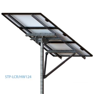

STP-LCR/124HW Mount Design:
  • Compatible with 60 and 72 cell modules that are less than 41" wide
  • Module Capacity: Three
  • Module Orientation: Landscape
Tamarack Solar top of pole mounts are designed with flexibility in mind. They are designed to fit schedule 40 or 80 steel pipe with a 6 inch diameter and the tilt angle can be adjusted from 0° to 60° (in 10° increments) for installations in a wide range of locations. The new universal heavy duty mounts are designed to safely and securely hold large 60 cell or 72 cell solar modules and withstand winds up to 150 MPH. These mounts are manufactured using galvanized steel and heavy-duty corrosion-resistant 5000 series aluminum. No additional up-charges for galvanized steel components.
STP-LCR/124HW Specifications:
  • Required pole diameter of 4", schedule 40
  • Maximum 6 foot (72 inches) height to top of pole (from ground level)
  • Stainless steel hardware
  • Max wind speed: 150 miles per hour
