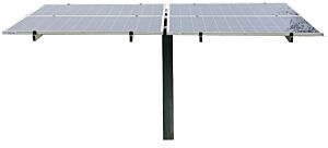

Tamarack Solar TTP-4 HW Top of Pole Mount
Mount Four Module with a total area of 100 square feet or less on a 6-inch schedule 40 or 80 pole.
Note: The Vertical Post (40 or 80) 4-inch schedule pole is user supplied.
  • 85-inch rails per column accomodate 4 modules with widths up to 41.25 inches
  • Fits any module up to 41.25 inches wide with frames 30 to 40 mm thick
  • Mounts on user-supplied 6-inch schedule-40 or schedule-80 steel pipe
  • 0° to 60° tilt angle
  • Total shipping weight is 280 pounds in 6 boxes
  • Engineered for to 140 mph wind speeds and 100 psf snow load
