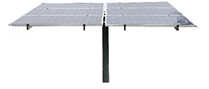

Tamarack Solar TTP-6-HW Top of Pole Mount
Mount Six Module with a total area of 149 square feet or less on a 6-inch schedule 40 or 80 pole.
Note: The Vertical Post (40 or 80) 4-inch schedule pole is user supplied.
- 131.5-inch rails per column accomodate 6 modules with widths up to 41.25 inches
- Fits any module up to 41.25 inches wide with frames 30 to 40 mm thick
- Mounts on user-supplied 6-inch schedule-40 or schedule-80 steel pipe
- No complex sizing documents or need to send module data sheets when ordering
- Heavy-Duty Steel structure and Tamarack 3.1 aluminum module mounting rails
- 0° to 60° tilt angle
- Total shipping weight is 260 pounds in 6 boxes
- Engineered for to 140 mph wind speeds and 100 psf snow load
