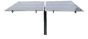

Tamarack Solar TTP-6 Top of Pole Mount
Mount Six Module with a total area of 149 square feet or less on a 6-inch schedule 40 or 80 pole.
Note: The Vertical Post (40 or 80) 6-inch schedule pole is user supplied.
  • 131.5-inch rails per column accommodate 6 modules with widths up to 41.25 inches
  • Fits any module up to 41.25 inches wide with frames 30 to 40 mm thick
  • Mounts on user-supplied 6-inch schedule-40 or schedule-80 steel pipe
  • 0° to 60° tilt angle
  • Total shipping weight is 190 pounds in 3 boxes
  • certified for to 110 mph wind speeds and 70 psf snow load
