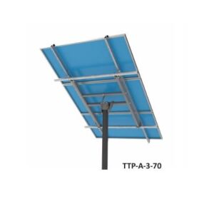

Tamarack Solar TTP-A-3-70 Three Module Top of Pole Mount
TTP-A-3-70
$1,383.75
Tamarack Solar TTP-A-3-70 Top of Pole Mount
Mount three modules with a total area of 75 square feet or less on a 4-IN Schedule 40 or 80 pole
  • Fits any module up to 46.16 inches wide with frames 30 to 40 mm deep*
  • Mounts on 4-IN Schedule-40 or Schedule-80 steel vertical post (user-supplied)
  • TTP-A-3-70 requires 2 sections of Schedule-40 pipe. (Purchase locally or order TP-PIPEKIT-SD4)
  • 10° to 60° tilt angle
  • UPS Shippable - total shipping weight is approx. 170 pounds in 4 boxes
  • Engineered for up to 160 mph wind speed and 200 psf snow load
SKUTTP-A-3-70
