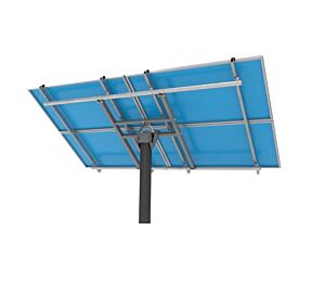

Mount Four Module with a total area of 100 square feet or less on a 6-inch schedule 40 or 80 pole.
Note: The Vertical Post (40 or 80) 6-inch schedule pole is user supplied.
  • 93-inch rails accommodate 4 modules with widths up to 45.5 inches
  • Module clamps fit frames between 30 to 40 mm deep
  • Mounts on user-supplied 6-inch schedule-40 or schedule-80 steel pipe
  • 10° to 60° tilt angle
  • Module Rails attach to 2-inch schedule 80 steel pipe. Purchase this pipe locally to save shipping cost or order appropriate length separately. Use two 10-foot pipes for module up to 78-inches long. Use two 12 foot pipes for modules up to 98-inches long
  • Engineered for to 160 mph wind speeds and 200 psf snow load
Note: Thicker solar module frames can be used by adding the Tamarack 89907 50/50+ Clamp.
TTP-A-4HW ships without 2-inch Schedule 40 pipe.
