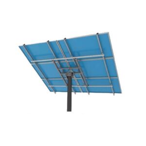

Tamarack Solar TTP-A-6-70 6 module pole top mount
TTP-A-6-70
$1,880.63
Tamarack Solar TTP-A-6-70 Top of Pole Mount
Mount 6 modules with a total area of 149 square feet or less on a 6-IN Schedule-40 or Schedule-80 pole
  • 140-IN rails accommodate 6 modules with widths up to 46.16 inches
  • Heavy-Duty steel structure and Tamarack 3.1 aluminum module mounting rails
  • 10° to 60° tilt angle
  • UPS Shippable (mulitple boxes)
  • Module clamps fit frames between 30-40mm deep*
  • Mounts on 6-IN Schedule-40 or Schedule-80 vertical steel post (user supplied)**
  • Engineered for up to 160 mph wind speed and up to 200 psf snow load depending on horizontal pipe and vertical post size used. See the charts on Tamarack website*** to determine appropriate sizes based on your location.
  • Module Rails attach to 2-IN Schedule-40 or Schedule-80** steel pipe (not included). Purchase this pipe locally to save shipping cost or see Tamarack PIPE KITS below to order the appropriate pipe size & length. If buying pipe locally, you will need:
    • (2) 10-foot Schedule-40 or Schedule 80** pipes for modules up to 78 inches long or
    • (2) 12-foot Schedule-40 or Schedule 80** pipes for modules up to 98 inches long
