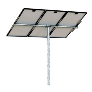

This kit is designed to work with solar panels with a Frame length of 38 to 72 inches long. Please see this kit UNI-PGRM/3P1-47 for application where the solar panel length is between 72 and 96 inches long.
- It's at least 38 inches from end to end on the inside end of the frame.
- Frame thickness is between 1.18 and 2.0 inches.
- Can mount almost any module, provided the following parameters are met:
- The full solar PV array falls within the total square footage limits for PGRM mount.
- The Mid/End clamps are suitable per specific module installation standards.
Two sizes of module clamps
- UNI-PGRM-END and UNI-PGRM-MID, 35-inch long for modules with frame length of 38 to 72 inches. Included
- UNI-PGRM-END47 and UNI-PGRM-MID47, 47-inch long for modules with frame length of 72 to 96 inches. Must be purchased separately.
- Number of Modules: 3
- Designed for 115 mph wind speeds, additional bracing is available for higher wind speeds
- Easily installed and adjusted by a single person
- Pre-galvanized
- Stainless Steel Hardware
