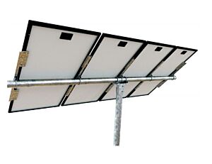

Tamarack Solar UNI-PGRM/4P1 Economy Horizontal Four Module Top of Pole Mount
Tamarack Solar UNI-PGRM/4P1 pole mount
This kit is designed to work with solar panels with a Frame length of 38 to 72 inches long. Please see this kit UNI-PGRM/4P2-47 for application where the solar panel length is between 72 and 96 inches long.
NOTE: A 4" SCH-40 support pipe and 3" SCH-40 main beam pipe are not included and must be supplied by the user.
- It's at least 38 inches from end to end on the inside end of the frame.
- Frame thickness is between 1.18 and 2.0 inches.
- Can mount almost any module, provided the following parameters are met:
- The full solar PV array falls within the total square footage limits for PGRM mount.
- The Mid/End clamps are suitable per specific module installation standards.
Two sizes of module clamps
- UNI-PGRM-END and UNI-PGRM-MID, 35-inch long for modules with frame length of 38 to 72 inches. Included
- UNI-PGRM-END47 and UNI-PGRM-MID47, 47-inch long for modules with frame length of 72 to 96 inches. Must be purchased separately.
The Horizontal Pole Mount is an extremely sturdy, universal pole mounting solution. With its user adjustable angle settings (0 to 60), the Horizontal Pole Mount can support installations in a wide range of locations.
- Number of Modules: 4
- Designed for 115 mph wind speeds, additional bracing is available for higher wind speeds
- Easily installed and adjusted by a single person
- Pre-galvanized, no upcharges for environmental challenged areas
- Stainless Steel Hardware
10 Year Warranty
