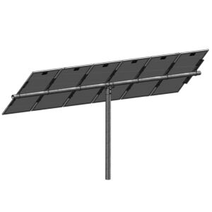

This kit is designed to work with solar panels with a Frame length of 38 to 72 inches long. Please see this kit UNI-PGRM/6P2-47 for application where the solar panel length is between 72 and 96 inches long.
- It's at least 35 inches from end to end on the inside end of the frame.
- Frame thickness is between 1.18 and 2.0 inches.
- No maximum length or width when the following parameters are followed:
- The full solar PV array falls within the total square footage limits for PGRM mount.
- The Mid/End clamps are suitable per specific module installation standards.
Two sizes of module clamps
- UNI-PGRM-END and UNI-PGRM-MID, 35-inch long for modules with frame length of 38 to 72 inches. Included
- UNI-PGRM-END47 and UNI-PGRM-MID47, 47-inch long for modules with frame length of 72 to 96 inches. Must be purchased separately.
The PGRM Series Pole Mount can be used to mount up to 6 solar modules with a frame thickness between 1.18” and 2”. You can install up to 92 sq. feet of modules on a single pole and up to 130 sq. feet of module on two poles. Note: The use of a single pole for 5 or 6 modules is for when you have smaller modules and should not be used with full size 60 cell or larger panels.
- Number of Modules: 6
- Designed for 115 mph wind speeds, additional bracing is available for higher wind speeds
- Easily installed and adjusted by a single person
- Pre-galvanized
- Stainless Steel Hardware
- Up to 92 square feet of modules on a single 4” Schedule 40 pole
- Up to 130 square feet of modules on two 4” schedule 40 poles
10 Year Warranty
