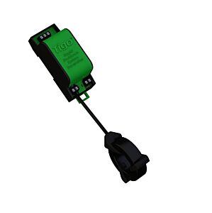

Tigo Single Core RSS Transmitter
The Tigo Rapid Shutdown System (RSS) Transmitter is part of a rapid shutdown solution when paired with Tigo TS4-F (Fire Safety), a PV module rapid shutdown unit. While powered on, the RSS Transmitter sends a signal to the TS4-F units to keep their PV modules connected and supplying energy. TS4-F units automatically enter rapid shutdown mode when the RSS Transmitter is switched off and resume energy production when power is restored to the RSS Transmitter. This solution complies with NEC 690.12 specifications for 2014, 2017, and 2020 and uses PLC signaling for rapid shutdown. The RSS Transmitter Outdoor Kit includes an RSS Transmitter, outdoor enclosure, 120/240VAC power supply, and one or two RSS Cores.
  • Max Current: Single Core: 150 Amps
  • Max String Voltage: 1500 Volts DC
  • Max Number of Strings: 10
  • Max Supported PV Modules per String: 30
  • Operating Temperature Range: -40°C to 85°C (-4°F to 122°F) in Outdoor Enclosure
  • Enclosure Environmental Rating: IP68, NEMA 4
