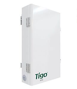

Tigo TSS-200-US 801-200200-0301 200A MCB Auto Transfer Switch (ATS) with Generator Support
Tigo EI Automatic Transfer Switch (ATS) TSS-200-US
The Tigo EI Automatic Transfer Switch (ATS) TSS-200-US (Part Number: 801-200200-0301) is a crucial component for grid-tied energy storage systems, facilitating seamless transitions between grid power and backup sources during outages.
Key Features:
- Automated Power Switching: Detects grid outages and swiftly transitions to backup power sources, maintaining uninterrupted electricity supply.
- Capacity: Supports up to 200A continuous current, suitable for essential load backup applications.
- Voltage Compatibility: Provides 120V and 240V split-phase output, accommodating various residential power requirements.
- Built-in Transformer: Enhances system reliability and efficiency by managing voltage regulation internally.
- Durable Enclosure: Features an IP65-rated, NEMA 4X enclosure, suitable for both indoor and outdoor installations, offering protection against dust and water ingress.
- Manual Bypass Switch: Includes a manual bypass option for maintenance or emergency situations, ensuring continuous power availability.
- Model: TSS-200-US
- Part Number: 801-200200-0301
- Maximum Continuous Input Current: 48A
- Rated Power: 11,400W
- Peak Power: 48,000W
- Dimensions(HxWxD): 17.9 x 21.6 x 9.6 in
- Weight: 65 lbs (29.5kg)
- Certifications: UL 1741, UL 869A, CSA C22.2 No. 107.1, CSA C22.2 No. 0.19
