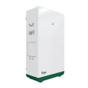

The Tigo EI (Energy Intelligence) Battery TSB-10/20-US is a high-performance energy storage solution designed to provide resilience during grid outages and optimize energy consumption based on utility rate plans.
This battery is an integral component of Tigo's EI Residential Solar Solution, seamlessly integrating with the Tigo EI Inverter to provide a comprehensive solar-plus-storage system for homeowners.
Key Features:
  • High-Performance Chemistry: Utilizes Lithium Iron Phosphate (LFP) technology for enhanced safety and longevity.
  • Flexible Capacity: Each TSB-10-US unit offers a usable capacity of 9.0 kWh, with the option to connect up to four units per inverter, achieving a total capacity of up to 36.0 kWh.
  • Robust Design: Encased in an IP56/NEMA 4-rated enclosure, suitable for both indoor and outdoor installations, ensuring durability in various environmental conditions.
  • Efficient Power Output: Delivers 5 kW continuous power with a peak output of 6 kW, supporting a wide range of household energy needs.
  • Operational Versatility: Supports load shifting, self-consumption, and backup applications, allowing homeowners to maximize energy savings and ensure power availability during outages.
  • Model: TSS-10-US
  • Battery Capacity:
  • Maximum Charge/Discharge Power:
  • Nominal Voltage:
  • Operating Voltage Range:
  • Dimensions:
  • Weight: Approximately 140 kg (308.6 lbs)
  • Operating Temperature Range: 10°C to +45°C (14°F to 113°F)
  • Certifications: UL 1973, UL 9540, FCC Part 15 Class B
