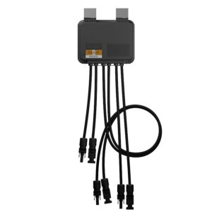

Tigo TS4-A-2F Module Level Fire Protection
NOTE: This unit requires the Tigo RSS Transmitter. Tigo TS4-A-F can be used with TS4-A-2F but cannot be used with TS4-A-M, TS4-A-S, TS4-A-0 units due to different communication architectures.
The Tigo TS4-A-2F is a reliable, cost effective rapid shutdown solution that meets the latest module level shutdown requirements, including NEC 2017/2020. It is UL PVRSS certified for connectivity with the largest network of inverters, many of which have a built in RSS transmitter. By connecting to two modules, the TS4-A-2F reduces labor time and enables 16% fewer connections on a 14 panel string compared to single channel MLPE.
TS4-A-2F Features:
  • Single MLPE (Module Level Power Electronics) connects to 2 PV modules
  • Meets US NEC rapid shutdown safety requirements
  • UL PVRSS certified with the largest network of inverters
  • 1000W (500W per channel)
  • 16-80V, 15A (per channel)
  • MC4 (standard) connectors
  • Snaps to module frame for easy mounting
  • Does not require ground wire
  • PLC communication
  • Configuration: 2 modules per TS4 unit
TS4-A-2F Specifications:
  • Manufacturer's part number: 484-00252-12
  • Outdoor rating: IP68, NEMA 3R
  • Voltage range input: 16 - 80 Volts DC
  • Max output voltage: 160 Volts (80V per input)
  • Max current (per input): 15 Amps
  • Max total power: 1000 Watts
  • Output cable length: 2.2 meters (7.2 feet)
  • Cable connectors: MC4
  • Rapid shutdown UL listed: Yes (NEC 2014 & 2017, 690.12)
