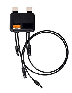

Tigo TS4-A-F 22A Module Level Fire Protection with Rapid shutdown
The TS4-A-F 22A enables cost effective rapid shutdown functionality in a 1 module to 1 TS4 configuration. The TS4-A-F 22A is both IEC and UL certified for global acceptance. The TS4-A-F 22A is UL PV Rapid Shutdown System (PVRSS) certified with hundreds of inverters to comply with NEC 2014, 2017, and 2020 rapid shutdown requirements. Many of the inverters have integrated the RSS transmitter, which communicates with the TS4-A-F 22A over PLC, enabling plug and play installations.
Benefits
  • IEC and UL certified
  • Meets US NEC rapid shutdown safety requirements
  • UL PVRSS certified with the largest network of inverters
  • Up to 725W per channel
  • 12-80V, 16/22A (per channel)
  • MC4 (standard) connectors
  • Snaps to module frame for easy mounting
  • Does not require ground wire
  • PLC communication
TS4-A-F Specifications:
  • Manufacturer's part number: 519-340112-2001
  • Outdoor rating: IP68, NEMA 3R
  • Voltage range input: 12 - 80 Volts DC
  • Max current (per input): 16/22 Amps
  • Max total power: 725 Watts
  • Output cable length: 1.2 meters (3.94 feet)
  • Cable connectors: MC4
  • Rapid shutdown UL listed: Yes (NEC 2014 & 2017, 690.12)
