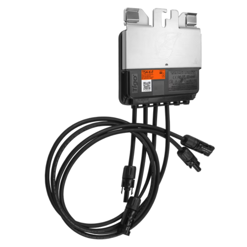

Tigo TS4-X-F Rapid Shutdown – Fire Safety, No CCA Needed
The Tigo TS4-X-F provides plug-and-play rapid shutdown for PV modules, enabling NEC 690.12 compliance without needing additional communication hardware. This Fire Safety solution deactivates PV output during grid shutdowns or emergencies, offering a cost-effective way to meet code requirements.
Ideal for installers seeking simplicity and safety, the TS4-X-F supports up to 700W modules and requires no TAP or Cloud Connect Advanced (CCA). It uses module-level electronics to shut down automatically based on inverter signals and features a 25-year warranty. Built with MC4-compatible connectors for easy integration.
  • Product Type: Module-level shutdown device (MLPE)
  • Functionality: Rapid shutdown
  • Max Input Voltage: 80 V
  • Max Input Current(Imp/Isc): 20A/25 A
  • Maximum Wattage: 800 W
  • Compatibility: PV modules up to 800W
  • Connector Type: MC4 or MC4-compatible
  • Cable length: 1.2M
  • Dimensions (L x W x H): 5.4 in x 5.5 in x 0.9 in
  • Weight: 1.15 lbs
  • Certifications: FCC, IC, CE-EMC, CE-RED, CISPR 31, CSA 22.2, IEC 62109, UL 1741 PVRSE/PVRSS, UL3741 PVHCE
