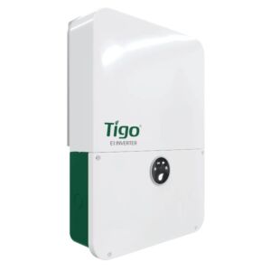

Tigo TSI-7.6K-US 7.6kW Energy Storage Hybrid Inverter
The Tigo EI Inverter is a powerful and flexible solution designed for efficient energy management in residential solar systems. Available in multiple power ratings, this hybrid inverter seamlessly integrates with Tigo Energy Intelligence technology to optimize system performance. It supports both on-grid and off-grid configurations, offering reliable energy storage and backup power capabilities.
With advanced monitoring through the Tigo Energy Intelligence platform, users gain real-time insights into system performance. The inverter is compatible with various battery systems, including the Tigo EI Battery, enabling tailored energy storage solutions. Built for durability, the Tigo EI Inverter features a compact design for easy installation and robust performance even in demanding conditions.
  • Up to 200% DC oversizing (2:1 DC/AC ratio)
  • 80 V starting voltage
  • Number of MPPTs: 3
  • Powered by the Tigo Energy Intelligence platform
  • NEC 690.12 rapid shutdown compliant
  • Imbedded WiFi dongle for local and remote monitoring
  • Cellular communications for data backup (optional)
  • Lightweight (32.3 lb.)
  • <10 min. commissioning (including Tigo TS4s) with EI mobile app
  • 152 month (12.5 years) standard warranty
  • Input(PV)
    • Max. recommended power (STC): 15200W
    • Max. DC system voltage: 600 V
    • MPPT voltage range: 80 V ~ 550 V
    • Full-load voltage range: 200 V~500 V
    • MPPT: 3
    • PV strings per MPPT: 2
    • Max. input current per MPPT (IMP/ISC): 13.5 A/16.9 A
  • Battery(DC)
    • Nominal DC voltage: 400V
    • I/O DC current: Up to 21.7 A
    • I/O DC power: 7800 W
  • Output(AC)
    • Nominal power @208V/240 V: 6580 W/ 7600 W
    • Max. apparent power: 7600 VA
    • Nominal voltage: 208 V/240 V
    • Grid frequency: 50/60 Hz
    • Max. output current: 32 A
  • Output(Backup)
    • AC nominal power: 7600 W
    • Max. AC power output: 12000 VA
    • Nominal AC voltage: 240 V
    • Max. output current: 50 A
  • General
    • Dimensions (W x D x H): 15.8 x 7 x 22 in.
    • Weight: 32.3 lb.
    • Enclosure: NEMA 4X/IP65
The Tigo EI Inverter is the ideal choice for residential solar installations that demand efficiency, reliability, and advanced monitoring capabilities. Pair it with Tigo’s comprehensive Energy Intelligence solutions for maximum energy independence.
