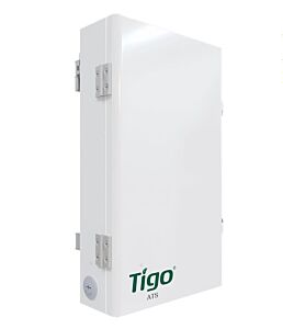

Tigo Tigo EI Automatic Transfer Switch (ATS) TSS-50-US
The Tigo EI Automatic Transfer Switch (ATS) TSS-50-US (Part Number: 604-00050-00) is an essential component for grid-tied energy storage systems, ensuring seamless transition between grid power and backup sources during outages.
Key Features:
- Automated Power Switching: Detects grid outages and swiftly transitions to backup power sources, maintaining uninterrupted electricity supply.
- Capacity: Supports up to 50A continuous current, suitable for essential load backup applications.
- Voltage Compatibility: Provides 120V and 240V split-phase output, accommodating various residential power requirements.
- Built-in Transformer: Enhances system reliability and efficiency by managing voltage regulation internally.
- Durable Enclosure: Features an IP65-rated, NEMA 4X enclosure, suitable for both indoor and outdoor installations, offering protection against dust and water ingress.
- Manual Bypass Switch: Includes a manual bypass option for maintenance or emergency situations, ensuring continuous power availability.
- Model: TSS-50-US
- Part Number: 604-00050-00
- Maximum Continuous Input Current: 48A
- Rated Power: 10,000W
- Peak Power: 12,000W
- Dimensions(HxWxD): 18.9 x 10.8 x 4.1 in
- Weight:33 lbs (15kg)
- Certifications: UL 1741, CSA C22.2 No. 107.1
