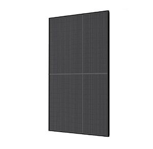

TSM-390-DE09C.07 Specifications:
  • Power at Mpp: 390 Watts
  • Isc: 12.14 Amps
  • Voc: 40.8 Volts
  • Imp: 11.54 Amps
  • Vmp: 33.8 Volts
  • Efficiency: 20.3%
  • Cell: 120 cells
  • Maximum system voltage: 1500 Volts
  • Connector type: MC4
  • Dimensions: 69.06" x 43.15" x 1.18" (30mm)
  • Weight: 46.3 pounds
