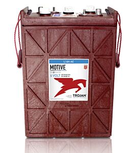

Trojan L16H 6 Volt, 435 AH Deep Cycle Battery
L16H-AC
$578.86
L16H 435 Amp-Hour Deep Cycle Battery, 6 volts.
This is the 435 amp-hour, 6-volt deep cycle battery from Trojan, in the L16 size. These can be used in RV's, homes, cabins and most renewable energy systems.
Specifications
  • 6 Volts
  • 435 Amp-hours at the 20 hour rate
  • Dimensions: 11.625"L x 7.125"W x 16.75"H
  • Weight: 121 pounds
  • BCI Group Size: L16
Warranty: 1 year
