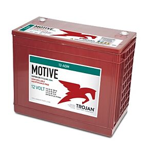

This is the 140 amp-hour, 12 volt AGM series battery from Trojan. The sealed AGM lead-acid batteries are intended for solar and other renewable energy systems. It has a maroon case made of polypropylene. The battery terminals are 10-32 bolt size with UNF threads. AGM batteries are generally considered to be "maintenance free" because they are sealed and do not require water to be added.
Specifications
- 12 Volts
- 140 Amp-hours at the 20 hour rate
- Dimensions: 13-7/16"L x 6-3/4"W x 10-7/8"H
- Weight: 100 pounds
- BCI Group Size: GC12
