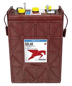

This is the 415 amp-hour, 6-volt solar series renewable energy battery from Trojan, in the popular "Golf Car" size. The renewable energy series are intended for solar and other renewable energy systems.
Specifications
  • 6 Volts
  • 377 Amp-hours at the 20 hour rate
  • Dimensions: 11.66"L x 6.94"W x 17.55"H
  • Weight: 118 pounds
Warranty: 7 Years (2 Years Free Replacement - 5 Years Prorated)
