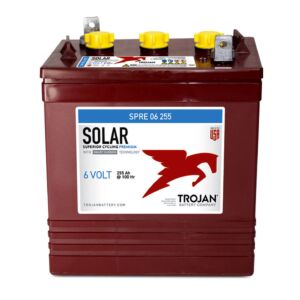

Trojan Solar SPRE 06 255 6 Volts, 229 AH Deep Cycle Battery
SPRE 06 255
$277.28
Trojan SPRE 06 255, 229 Amp-Hour Deep Cycle Battery
This is the new 229 amp-hour, 6-volt solar series renewable energy battery from Trojan, in the popular "Golf Car" size. The renewable energy series are intended for solar and other renewable energy systems.
Specifications
  • 6 Volts
  • 229 Amp-hours at the 20 hour rate
  • Dimensions: 10.3"L x 7.13"W x 11.74"H
  • BCI Group Size: GC2H
  • Weight: 67 pounds
Warranty: 7 Years (2 Years Free Replacement - 5 Years Prorated)
