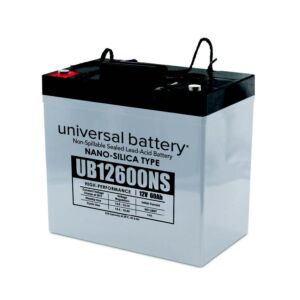

Universal Battery 47633 60 Amp-hour 12 Volt Nano-Silica GEL Battery
47633
$122.67
Universal Battery 47633 60 Amp-hour 12 Volt Sealed GEL Battery - 22NF
Utilizing advanced technology, Universal Battery Nano-Silica Batteries deliver superior cycle life, extended shelf life, and improved charge acceptance compared to traditional GEL batteries. Nano-Silica technology also provides additional battery cycles and longer shelf life compared to AGM batteries, while maintaining high capacity and offering more power than both AGM and GEL batteries.
Nano-Silica is produced by significantly reducing the size of fumed silica particles. This reduced size allows a colloidal solution of Nano-Silica and lead-acid electrolyte to easily penetrate the AGM microfiber plate separator material. This eliminates the need for the semi-rigid separator typically used in traditional GEL battery construction. Removing the semi-rigid separator brings the plates closer together while still offering improved temperature control and reduced acid stratification. Consequently, Nano-Silica batteries combine the advantages of AGM construction with the enhanced temperature control and reduced acid stratification of GEL batteries, resulting in superior battery technology compared to conventional AGM and GEL batteries.
Engineered for: Data Centers, Medical, Oil & Gas, and Solar.
  • Superior power for critical applications
  • Longer life compared to traditional AGM batteries
  • Outstanding performance, withstanding high current output and deep cycling
  • Excellent resistance to vibration, shock and heat
  • No electrolyte stratification
  • Maintains high capacity while providing more power
  • Will not spill or leak
  • Can mount in any position
  • No gassing
  • Recombinant electrolysis
  • High discharge capable - C/2 or 1C rate
  • High cycle-life - 375 cycles at 100% DOD
  • High charge efficiency
  • High charge voltage. Equivalent to AGM
  • Higher charge current than traditional GEL. Around 25% of rated battery capacity
  • Improved temperature performance. Operating range - 20°C to +60°C
Specification:
  • Nominal Voltage: 12 Volts
  • Nominal Capacity: 60 Ah @ 20-hour rate
  • Float Use: 13.8-14.1V
  • Terminal type: I6 Series
  • Dimensions(LxWxH): 9.01" x 5.44" x 8.35"(TH:8.46)
  • Weight: 35.3 lbs
SKU47633
