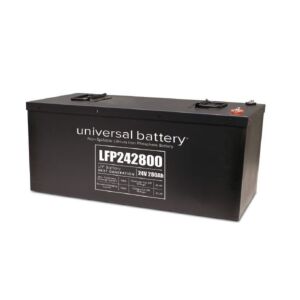

For over fifty years, UPG reliable batteries have been the choice for powering essential and critical applications worldwide. UPG is dedicated to delivering exceptional quality, performance, and customer experience in every product. Our custom-engineered LiFePO4 (LFP) batteries represent the latest in battery technology. These ultra-lightweight, high-performance batteries outshine traditional sealed lead-acid batteries, delivering superior power even in the harshest conditions.
Experience a new era of energy with LFP Batteries—where Lithium Iron Phosphate technology meets unparalleled power and sustainability. UPG batteries redefine reliability, offering a resilient and enduring energy solution for a wide range of applications.
  • Cycle Life over 2000 cycles
  • Low Voltage Cutoff built inside the battery so you cannot damage the battery
  • High Current Cutoff built inside the battery so you cannot overload or damage the battery
  • Low and High Temperature cutoffs inside the battery so you cannot damage the battery
  • Close to 100 percent of the battery capacity even at higher currents
  • Model number: LFP242800
  • UPG number: 48097
  • Nominal voltage: 25.6
  • Nominal capacity at 77°F: 280 Amp-hours (Ah)
  • Weight: 108 lb (49.0 kg)
  • Dimensions (inches): 20.6"L x 10.2"W x 8.66"H; Total height: 9.37"
