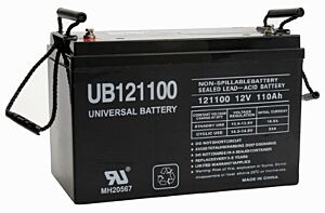

Universal UB121100 (45981) 12V SLA AGM 110Ah Deep Cycle Battery
NOTE: If you need help determining the correct wire size, breaker size, or fuse size for your battery system, please give us a call or email us and we will be happy to assist you.
UPG discharging recommendation: this battery should not be discharged beyond a 40% depth of discharge (DOD). That means the battery should retain no less than 60% of its rated capacity. If the battery is drawn below that threshold, it could prevent the battery from returning to a full charge.
Experience matters in the battery industry and UPG has perfected the business model since their beginning in 1968. UPG takes the quality of their products very seriously. They are an ISO 9001:2008 certified company that abides by very strict quality management standards. Battery inventory is rotated on a regular basis to prevent spoilage and every battery is top charged before leaving the warehouse. This ensures that your batteries will arrive healthy and ready to be installed upon delivery. The Universal line is well suited for both solar and wind power applications. When combined with a properly sized solar array or wind turbine, these batteries will give you years of energy storage at a much lower cost than the name brand alternatives. UPG promises exceptional quality, environmental responsibility, excellent value and reliability for all your renewable energy storage needs.
  • Model number: UB121100
  • UPG number: 45981
  • Nominal capacity at 77°F: 110.0 Amp-hours (Ah) at 20 hour rate
  • Group Size: 30H
  • Maximum charging current: 33 Amps
  • Internal resistance: 5 megohms
  • Terminals: I Series internal threaded bolt
  • UL recognized under file number MH 20567
  • Weight: 65.7 lb (29.8 kg)
  • Dimensions (inches): 12.97"L x 6.89"W x 8.4"H; Total height: 8.57"
