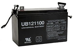

UPG Universal Battery UB121100 110 Amp-hours 12V Sealed Lead Acid AGM Battery with Stud Terminals

  • Model number: UB121100
  • UPG number: D5751
  • Nominal capacity at 77°F: 110.0 Amp-hours (Ah) at 20 hour rate
  • Group Size: 30H
  • Maximum charging current: 33 Amps
  • Internal resistance: 5 megohms
  • Terminals: L Series stud terminals
  • UL recognized under file number MH 20567
  • Weight: 65.7 lb (29.8 kg)
  • Dimensions (inches): 12.97"L x 6.89"W x 8.4"H; Total height: 9.32"
