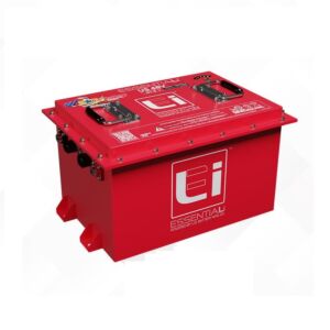

U.S. Battery Essential LI US 48V 105
Introducing the U.S. Battery Essential LI US 48V 105, a powerful and efficient deep cycle lithium-ion battery designed to deliver exceptional performance and reliability. This advanced battery is engineered with Lithium Iron Phosphate (LFP) cells, ensuring superior safety and longevity for a wide range of demanding applications.
Key Features:
  • Voltage and Capacity: The US 48V 105 operates at 51.2 volts with a high capacity of 105 Ah.
  • Dimensions and Weight: This robust battery measures 12.60” (320mm) in width, 17.44” (443mm) in length, and 10.32” (262mm) in height, with a weight of 92.6 lbs (42 kg).
  • Battery Management System (BMS): Equipped with a state-of-the-art BMS that utilizes intelligent algorithms to ensure accurate State of Charge (SOC), advanced cell balancing, and enhanced fault detection and handling.
  • Waterproof and Maintenance-Free: The IP67-rated construction protects against dust and moisture, ensuring durability and maintenance-free operation in various environments.
  • Fast Charging: Capable of reaching a full charge in as little as 3 hours, minimizing downtime.
  • CAN Networking: Automotive-grade connections allow integration with motor controllers and chargers, facilitating communication of battery status.
  • Integrated Heat Sink: Built-in heat sink helps dissipate heat, preventing overheating and enhancing performance.
  • Wake/Status Button: Allows users to turn off the battery for maintenance or long-term storage.
  • Max Continuous Discharge Current: 150A
  • Max 15s Discharge Current: 250A
  • Max 0.2s Discharge Current: 300A
  • Case Material: SECC Steel
