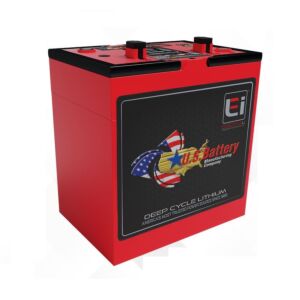

U.S. Battery Essential LI US 48V G24
Introducing the U.S. Battery Essential LI US 48V G24, a high-performance, deep cycle lithium-ion battery designed to meet your power needs. Engineered with automotive-grade Lithium Iron Phosphate (LFP) cells, this battery ensures exceptional performance, reliability, and safety for a wide range of applications.
Key Features:
  • Voltage and Capacity: The US 48V GC2 operates at 51.2 volts and offers a capacity of 30 Ah.
  • Dimensions and Weight: This battery measures 10.24” (260mm) in length, 7.09” (180mm) in width, and 11.04” (280mm) in height, with a weight of 32.2 lbs (14.6 kg).
  • Battery Management System (BMS): Features a state-of-the-art BMS that utilizes intelligent algorithms to ensure accurate State of Charge (SOC), advanced cell balancing, and enhanced fault detection and handling.
  • Waterproof and Maintenance-Free: The IP67-rated construction safeguards against dust and moisture, ensuring durability and maintenance-free operation in various environments.
  • Fast Charging: Capable of reaching a full charge in as little as 3 hours, minimizing downtime.
  • CAN Networking: Automotive-grade connections allow integration with motor controllers and chargers, facilitating communication of battery status.
  • Integrated Heat Sink: Built-in heat sink helps dissipate heat, preventing overheating and enhancing performance.
  • Wake/Status Button: Enables users to turn off the battery for maintenance or long-term storage.
  • Max Continuous Discharge Current: 100A
  • Max 15s Discharge Current: 150A
  • Max 0.2s Discharge Current: 175A
  • Certifications: UN 38.3, UL2580 (Cells), UL2271 (Pack)
  • Case Material: ABS with Aluminum Heat Sink
