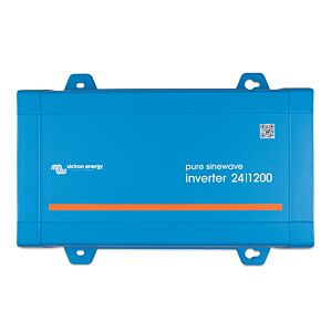

Victron Energy 24/1200 120V NEMA GFCI Inverter
This inverter allows you to power domestic equipment - requiring 120V AC - using 'leisure' or 'automotive' batteries rated at 24V DC.
The inverter with VE.Direct allow for communication from a computer with the the VE.Direct cable or a smartphone and tablet using the VE.Direct Bluetooth Smart dongle. This gives you the ability to fully configure the inverter to your needs. Proven reliability with the full bridge with toroidal transformer topology to provide reliable power over many years.
Feature & Specifications:
  • Output AC voltage: 120VAC
  • Output frequency: 60Hz
  • Continuous output power at 25°C: 1200VA
  • Peak power output: 2200W
  • Max efficiency: 91%
  • Zero load power: 8 Watts
  • Output Socket: NEMA GFCI
  • Dimensions(h x w x d): 4.6" x 9.1" x 14.2"
  • Weight: 16.3 lbs
  • Warranty: 5 years
SKUPhoenix Inverter-24/1200-GFCI
