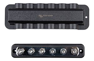

Victron Energy 250 Amp 6 Terminal Busbar
Busbars are used for high current distribution and at the same time they provide connections for batteries and/or DC equipment. The busbar comes with a removable protection cover for added safety.
250 Amp 6 Terminal Busbar Specifications:
  • Maximum current: 250 Amps DC
  • Maximum Voltage: 70 Volts DC
  • Terminal diameter: 5/16 inch
  • Terminal material: Stainless steel
  • Busbar strip material: Tin-plated copper
  • Busbar base material: ABS
  • Busbar cover material: ABS
  • Weight: 1.0 lbs.
  • Dimensions (H x W x D): 1.9 x 9.4 x 2.8 inches
